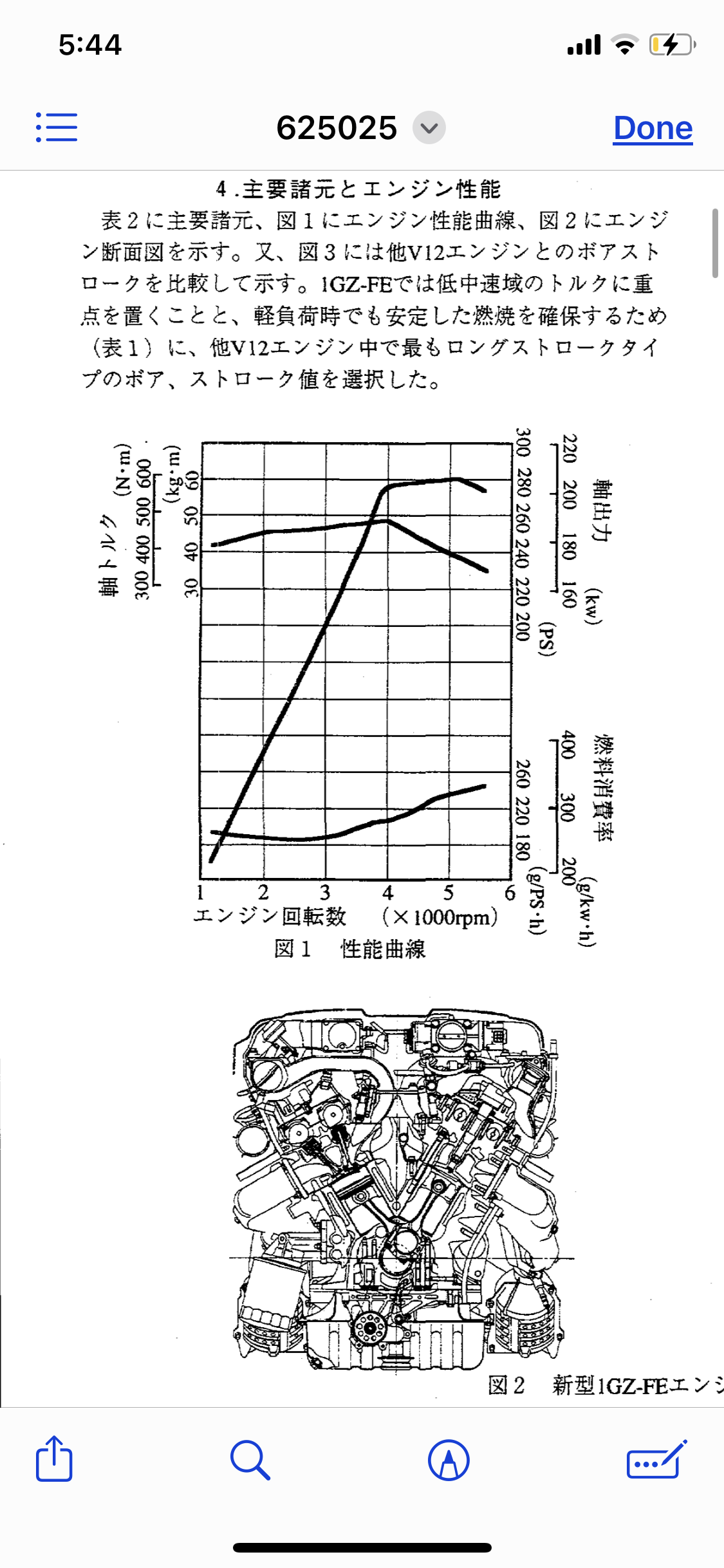

Yes, mine dyno’d at 303 wheel. It is entirely stock, 160,000 km. They are underrated, I think they make like 340 horsepower at the crank.
Check out the official dyno curve… don’t you think the engineers are sandbagging? See the unnatural power curve compared to a nice torque curve? Doesn’t add up.-Dave
