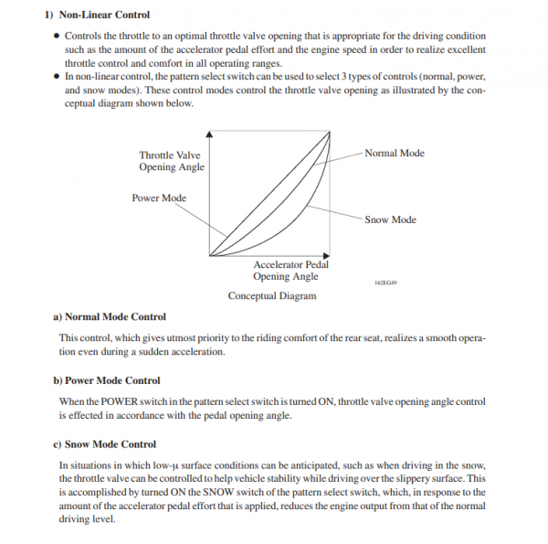

The car drives so much better with the PWR button switched on but I'm not exactly sure what it does. Does it only modify throttle sensitivity?

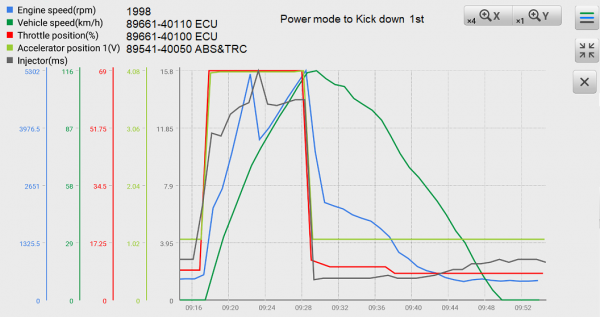

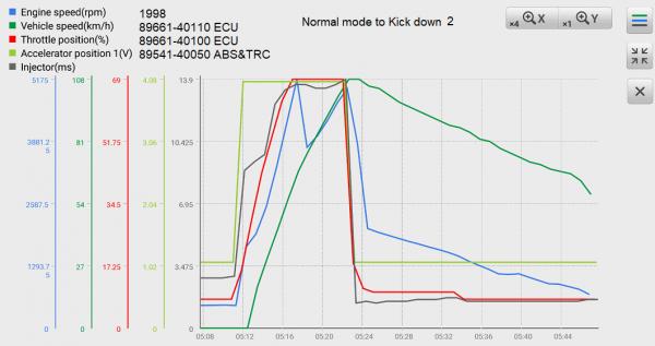

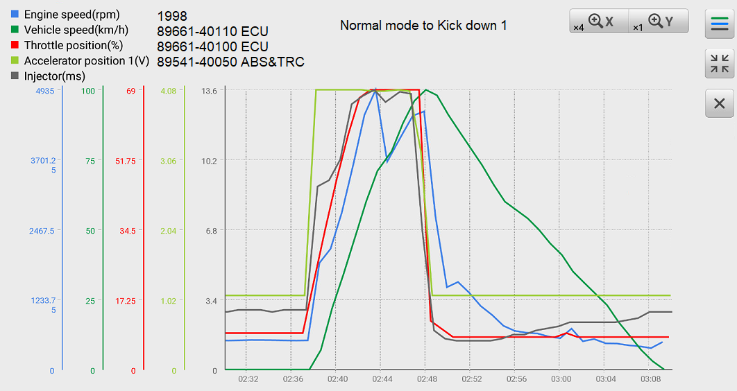

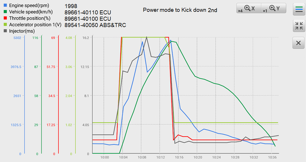

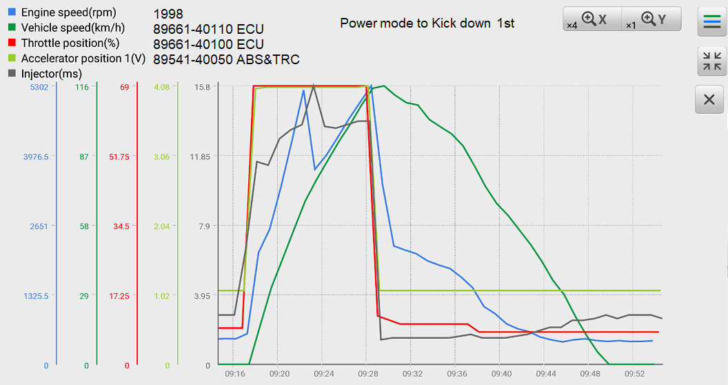

*data sample rate very low, might not be accurate
*Test with 275/40 R19
